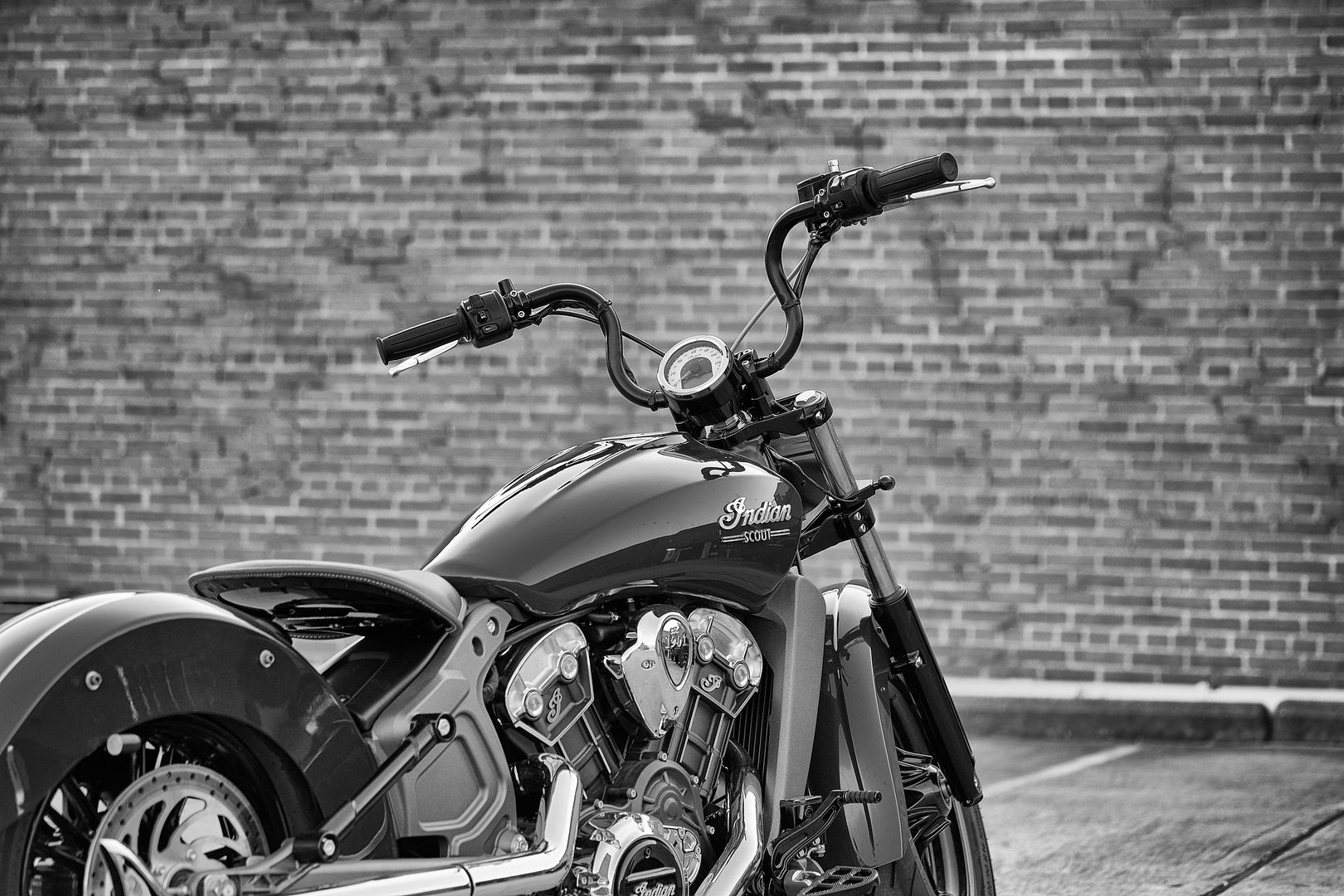

And cool handlebar. Which?
Wow, all the discussions about performance suspension and you just showed a picture of the exact opposite! How does the bobber seat take the excess shock? I am guessing the sprung seats I have seen from Mothers(?) would work well too, but that set up would not work for a passenger, huh?

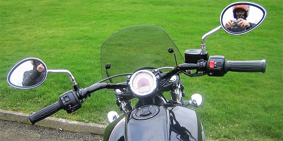

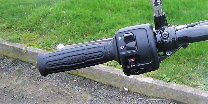

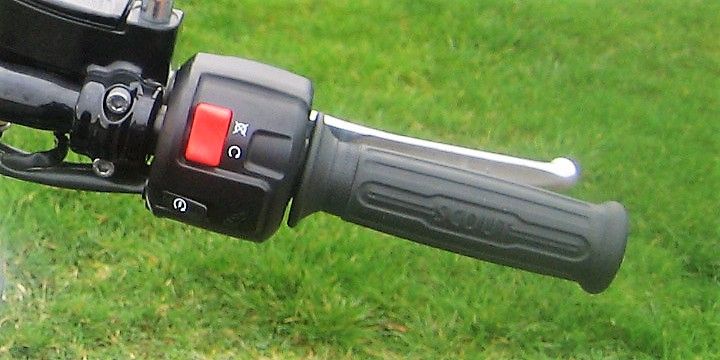

fitted Scout oversize grips, tried them today ... very comfy, a huge improvement over the stock grips, which I found too narrow..
was going to fit heated grips, got sidetracked with these, they come with integrated throttle tube which was a big plus for me.

it would be normal for 7/8" grips to be 7/8" clutch side and wider than that throttle side.
I changed to the Indian oversize grips. Stock throttle side came out with the tube when the 4x screws were removed ... remember its orientation, it needs to go back on aligned the same way. I had to cut the clutch side off. When you've removed the throttle side you should be able to cut the grip off and refit the heated grip. It may need trimming down to get the heated grip on the tube, don't know ... haven't done that bit (my throttle side grip came on a throttle tube). When you've got the heated grip on the tube it should fit back in the assembly and then you fasten the 4x screws.
