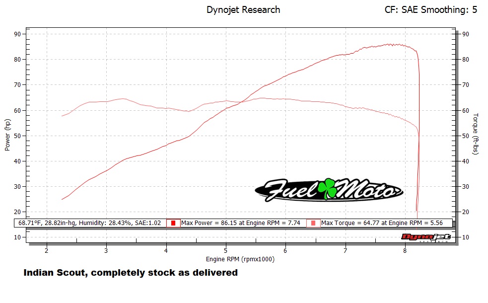

Firstly, see the 2 charts below - They show our "target" - typical power levels and curves for a stock S69

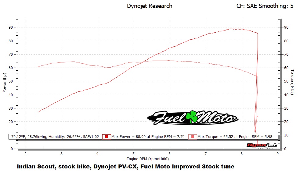

Now let us see our next "target" - A stock Scout 69 running a PVCX with FM's "improved stock" tune:

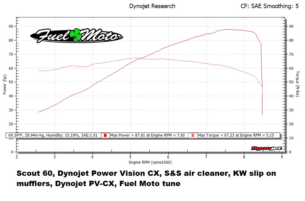

The below FM chart shows the proof. As noted, the S60 tune is using the S&S Intake and performance slipons.

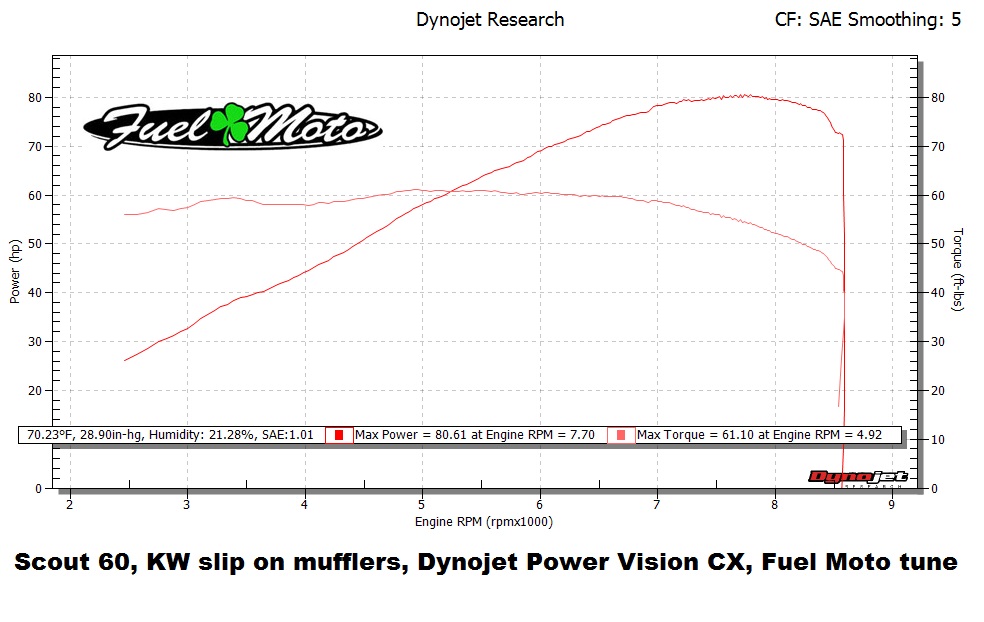

Since it is common to replace the stock slipons, the chart below is evidence of near parity between the S69 and the S60 + slipons + PVCX. ( Many charts for a stock S69 are in the area of 83-85 hp / 61 -64 lb ft TRQ. )

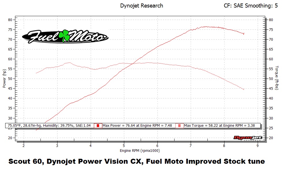

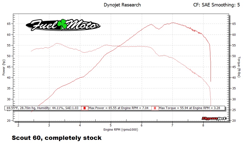

Stock S60 and Improved Stock (PVCX tuned) - These two charts below tells all S60 owners that a PVCX (preferably from Fuel Moto so as to get access to this tune) should be the first performance part added to a Scout 60. This alone is a radical change to your ride.. Imagine your bike with more power everywhere and a 12 - 15 hp ( up to +27% ) increase in the upper RPM range!

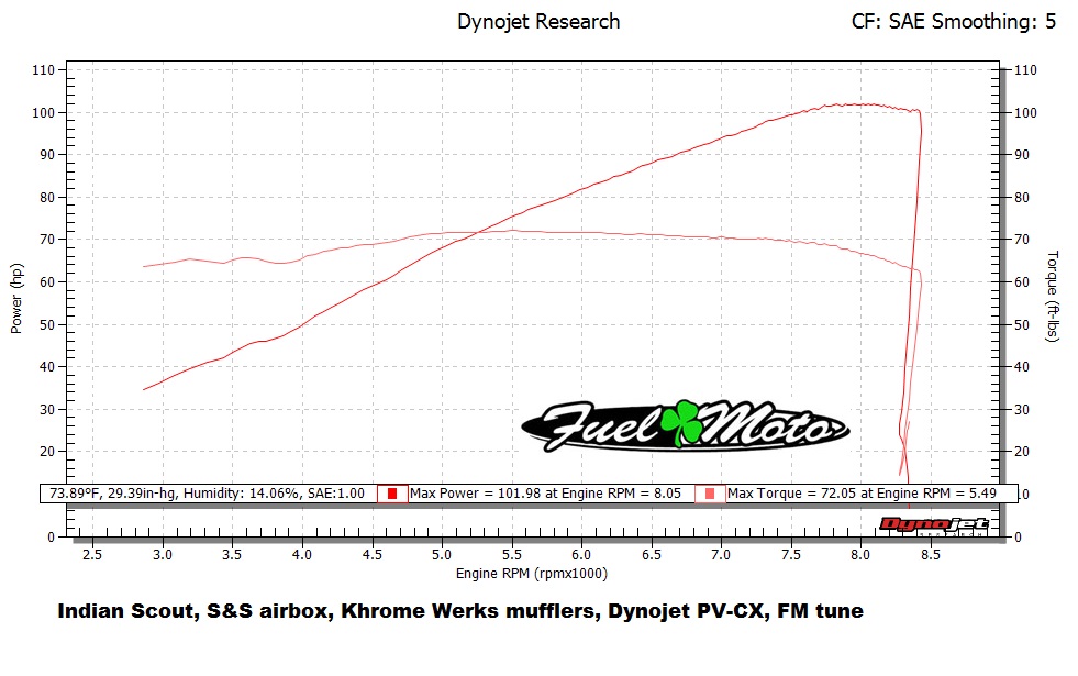

A note about S60 vs S69 for "power junkies".
As seen below, FM's tune development for the S69 indicates that a performance Intake and exhaust (a "stage 1" type setup) + PVCX will exceed 100 hp (102/72). This tune and chart are using the S&S intake and Khrome Werks slip-ons as the Stage 1 components, on a S69..
At this time, this power level is simply not attainable with a S60.
