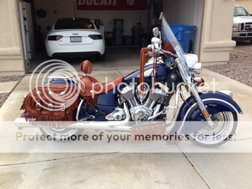

I didn't do it myself, but I had a local leather shop dye my leather using Fiebing's Oil Dye. Had this done over a month ago. The day I got it home, I went over it all pretty good with some 303. I've been away off and on, and have only ridden the bike 3 or 4 times since it was done. But, I am still getting dye residue all over the seat of my pants. For those who've dyed theirs, how long was it before it stopped happening? Or, did you use some sealant to prevent it? Thanks.
731 Posts
I also used fiebing's oil dye and tan kote sealant on my Vintage. Had to wash the bike a couple of times. When it no longer shed residue I oiled the leather to restore it's suppleness and then treated with 303 . Now no more shedding of excess dye.

Howdy Folks,
I haven't really understood why folks were freaking out so over their tan seats fading in the weather, I'd kind of expect it. I often apply dye to my motorcycle leathers, boots, gun leather, and leather saddles to touch them up. They acquire a very individual patina over time. I was thrilled when I heard Indian seats were going to be genuine leather from the git-go. The black saddle on my Chieftain has been drenched repeatedly with rain and exposed to blistering desert sunshine and is holding up well with occasional applications of saddlesoap and harness dressing. As for the dressing or dye coming off on clothes, why that's why bikers wear black.
By the way, Cattivo, your leather really looks good.
