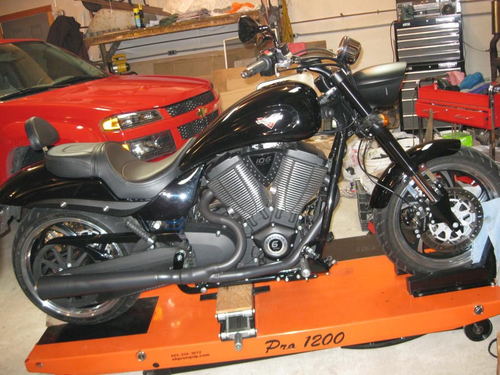

As BBob mentioned: if you have a standard lift and no tools to make a fancy plate, you can use window or door trim pieces to make an angled support. All it takes is a saw, tape measure and tape.
The beer in the picture is optional... And dont critizise my tape job; that's why I don't wrap presents.
Place the wooden wedges 2" apart for 6.5" total width. Cut them to 14" long if the lift arms are 12" across. To clear the side stand bracket enter the lift from the left side and roll the bike forward.
This setup is not great for an oil change, but good for everything else.

Good stuff Rainmaker, I've used one piece before to counter the lean, but amazingly never thought of using two!

Nice option but I did not have any problem raising bike in stable position when changing tires using jack without any shimming. Two of us so did make sure bike was stable when raising it high enough to get rear tire out. I was surprised how stable it was on jack. Was careful not to put jack plate under oil drain plug to keep weight off of it. Was concerned about weight change on jack when tire removed but found it was not a problem at all. Again... there were two of us so one person was there to stabilize bike in case it shifted on jack. Used Triple Tree Stands for front tire before changing Rear, but had to use jack for rear to get bike high enough to remove tire.

My helper was hiding because it was below freezing.. So to be on the safe side I made the wedges lifting it under the motor. If you lift it under the two frame protrusions it's straight too, but if the bike shifts and you are alone.. You are in trouble :)
