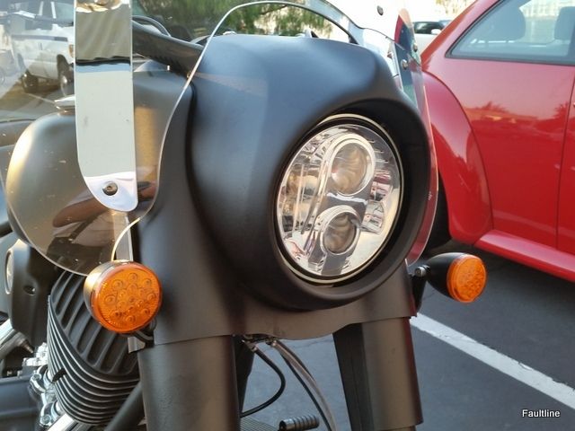

A little background: My normal commute is around 5:30 am through a 20 mile section of the Angeles National Forest. The Forest Service forbids cell towers and dislikes street lamps, so being able to see clearly is a priority.
And you can't just run the high beams all the time as the oncoming, jacked up 4X4's have enough light on their overhead racks to light up a runway. And I don't want to have to pull over until my night vision returns.
On Day One it became painfully apparent that the Quartz-Halogen bulb in the Dark Horse wasn't going to cut it.
I also had no interest in installing secondary driving lights (like the Chieftain's), or little LED's like the Twisted Throttle Denalis (which I have on another ride). For now, I wanted to keep the front end clean.
Since this was not my first Rodeo, I have a couple of boxes full of alternative bulbs from previous projects.
Stepping past the UltraStars, I pulled the Headlight Cover (PITA the first time, much faster thereafter) and installed a 3800 Lumen Cyclops Adventure H4 equivalent LED. A pair of these bulbs on my Weestrom will have oncoming traffic flashing their headlights at me, even on low beam.
For this application, the Cyclops worked pretty well, putting out a nice puddle of light in front of the bike at speed. The high beam was also acceptable. Since I had no oncoming headlight flashers, I'll assume that the low beam didn't annoy oncoming traffic.
The issue I had with this installation was with shadows and artifacts from the Dark Horse reflector. The reflector, while pretty clean with a Halogen, wasn't happy with the vertical divide in the LED array. Dark spots are what you look for (dirt and gravel kicked onto the road, or animals lurking on the road edges), and the shadows made me jumpier than I should be at that hour of the morning. If you're not riding in the pitch black, in the mountains, and you're on a budget, an LED might fit the bill for 'ya. (2015 VCM and up, of course).
I saw the Ironhorse projector headlight referenced in a couple of places, looked at the light patterns in the videos, and figured I'd mount one up and see how well it worked, (remember, I'm the dummy with a "box full of bulbs from previous projects"?).
Nothing much to report from the install. It was straightforward and took about an hour. The headlight bucket is ABS plastic, so trimming per the online instructions only took left and right handed Dutchmen (aircraft tin snips). A good pair of short kitchen shears or diagonal cutters might be a good alternative. I would not suggest any kind of knife. The headlight bucket material is going to spring back on you with bad results.
So, how do they work? Very nicely indeed. You get a nice lit spot directly in front of you at approximately legal cruising speeds. The projectors keep the beam centered in the road so you don't get the "bedazzled" traffic signs on the side of the road. Nice sharp beam cutoff with the bike tilted going around corners. The high beam is centered in the road, with a good lit distance but it doesn't light up the surrounding hillsides like the bulb does. I have had - zero - headlight flashes from oncoming traffic, so far.
More expensive than a bulb, and less expensive than the Roadmaster LED light (which I haven't tried).
And personally, I dig the Art-Deco look.

Hello Enzo, it was great meeting you, too.
AFAIK, there would have to be some complementary wiring in the handlebar controls.
The Dark Horse only has low and high beam (no driving lights), and the connector on the back of the headlamp is a standard 3 blade plug.

Got it....I think. So what you showed me yesterday was Low Beam (no Running lights) and Hi Beam (w/Running lights) Correct?
Hey guys, I run IronHorseLights and was happy to see my product made it to this forum before me.
Faultline (or Dave), as you have seen on my website, I run low on photos, and was wondering if you mind if I used your shot on the product page. By the way, thank you for the positive review.
Enzo, to answer your question, if you get only the headlight (which Faultline/Dave did), you get low beam and high beam only. If your bike has driving lights (or spot lights as some call them), then that's a separate upgrade. Regardless which lights you upgrade on the bike, your controls and wiring does not change. If your bike has already driving lights then you can upgrade them to the Chief Can See LED driving lights. If not, then you can only upgrade what you have, namely the headlight. The wiring is all plug-and-play (disconnect factory bulb, plug in LED light).
C.R.

C.R. Sure, feel free to use that shot.
