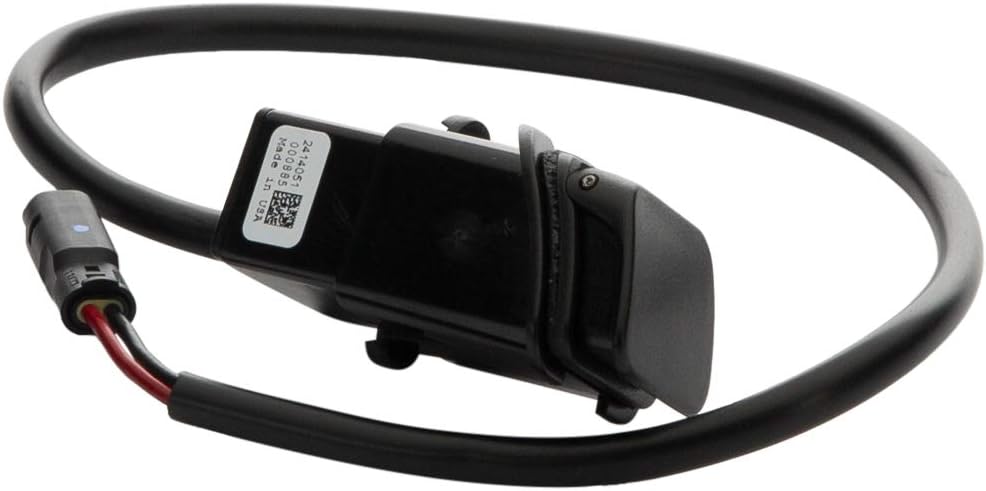

  1. Purchase P/N 2883689, to get the USB port only.

Hi mate, thanks for your detailed description. I have a 2018 Indian Scout Bobber and I’ll follow your advice. Just one question. When I purchase the usb port cable P/N 2883689 you listed above, does that plug into this cable under the speedometer housing? Or, will I need to do more with the electrics.

That connector on the usb , does anyone know what its called because i could buy one of those and wire any usb into it.
